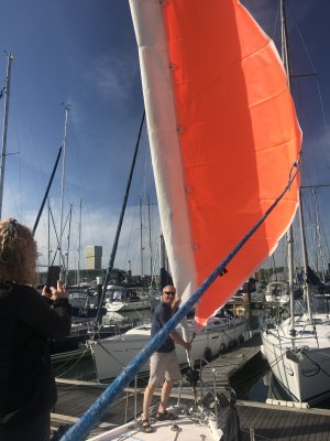

When I got my boat yrs ago, there was an inner forestay, but never fitted to a deck fitting. The storm was in good condition but with a rusty luff and fittings. Local sailmaker replaced the luff with rope, fitted new cringles and hanks. For the inner forestay I fitted a dual Wichard deck fitting both above and below deck with a turnbuckle to the reinforced bow bulkhead(with an easily opened hatch to get to the anchor chain). For the the forestay deck fitting I had an overcentre turnbuckle for tightening the stay. The stay is usually lashed to the toe rail. Tested it in a F3/4 and it worked well, but never tested in a real storm yet. The sail also has its own sheets.

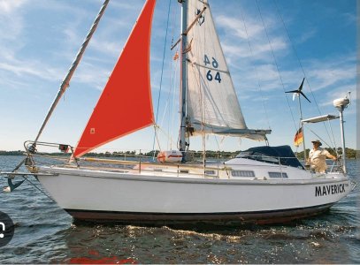

If doing an Ocean crossing I would definitely want a storm jib - and on an inner forestay, never a wrap around one as in conditions that might need I would not want to phaffing around on the foredeck.

Following his advice and having a high viz easily hoisted storm jib, well practised in light winds has served me well.
Having also taken yachts on long offshore passages without one too, I learnt the advantages of stout storm canvas. Experience of breaking waves also reinforced the idea of keeping storm jibs well above the deck. Tons of water crashing aboard raises an awareness of the power of the sea that few sailors experience. Although somewhat alarming. I feel privileged to have been through those circumstances.
