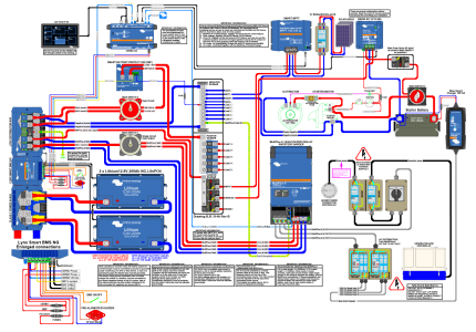

Something like this without the generator ...
You are overthinking the Li batteries, just stack them in parallel and let the BMS take care of them.
https://www.victronenergy.com/uploa...50-SBP-220-generator-MPPT-100-50-Orion-XS.pdf
View attachment 206899T
here are loads of Victron schematics for all sorts of systems here ... Victron Energy | Independent energy systems engineered to outlast
Several single points of failure between the batteries and the isolator though ?
