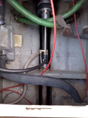

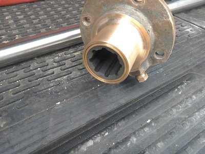

Yes, very common to have a Stuart Turner bearing housing machined to take a cutless rather than the original rubber. It is 3" or so long so the excess is cut off flush. In my latest project which has a very long shaft we also had the inboard end which carried the old stuffing box machined to take a 2" length of cutless and the outside to take a Radice seal. First did this 30 years ago when I replaced the Stuart Turner with a Yanmar 1GM. The shaft is supported at both ends and a bulflex coupling allows the engine to move around. First photo is the inboard end and second is the installation with the seal on and showing the Bullflex coupling
That's a very neat solution. Including the grub screw to stop spinning.
Thanks for posting.
