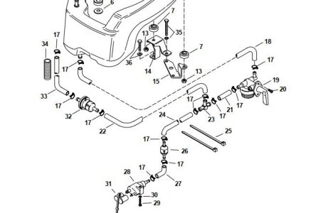

Can you find an exploded diagram of your OB fuel system and check if there's some kind of valve or 3 way tap?
This is an interesting thought! I do think the petcock is an either/or valve meaning that if I select the external tank, then the internal tank is blocked off, and likewise if I select internal, then the external tank is blocked ... however that's just been my assumption to this point. I wonder what happens in reality or what happens if it wasn't completely set to internal as I had thought. Hmmm
No, it's not a diverter valve, see the attached diagram (Tohatsu 4/5/6 service manual).
The fuel lines from both tanks join in a tee (#23) on the carb side of the fuel tap. With the fuel tap open both tanks are connected to each other and the carb.
There is a non-return valve (#26) in the line between the external tank connector and the tee that stops fuel flowing back into the external tank, but nothing to stop fuel flowing from the external to the internal.
P.S. my external tank is the old sort with an normal open vent, but if you have one of the latest 'pressurised portable tanks' (didn't even know they existed) then they run pressurised and only vent once 5psi is reached - already enough pressure to pump fuel into your vented internal tank if the tap is open.
So for correct operation:
- disconnect the external tank at the connector when using the internal tank.
- keep the internal tank's fuel tap closed when using the external tank.
The light bulbs are going off. It's possible I'm having two separate issues with the same symptom. My stalling issue happens with both the top tank and bottom tank. However this theory of flooding the bowl because of my overfilled internal tank due to fuel being pushed up makes a lot of sense! The gas level was clearly above the bowl.
Thanks for the diagram and the walkthrough. It's possible that my issue in both cases (external tank stall, and internal tank stall) might be due to the external tank. When running from my external tank, I think the EPA valve might be stuck, which may be starving my engine, and when running the internal tank I might be receiving fuel from the external tank flooding the carb.
