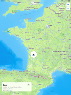

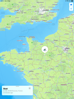

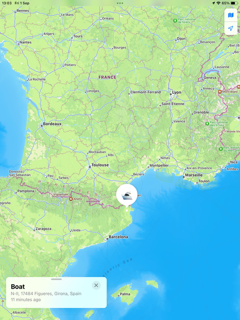

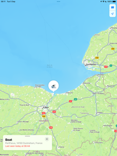

I put an Apple tag tracker on my boat and watched it go through France. There seemed to be lots of long stops and of course no weekend movement. A really frustrating job I reckon
First pic Sept 1st, last one Sept 5th
