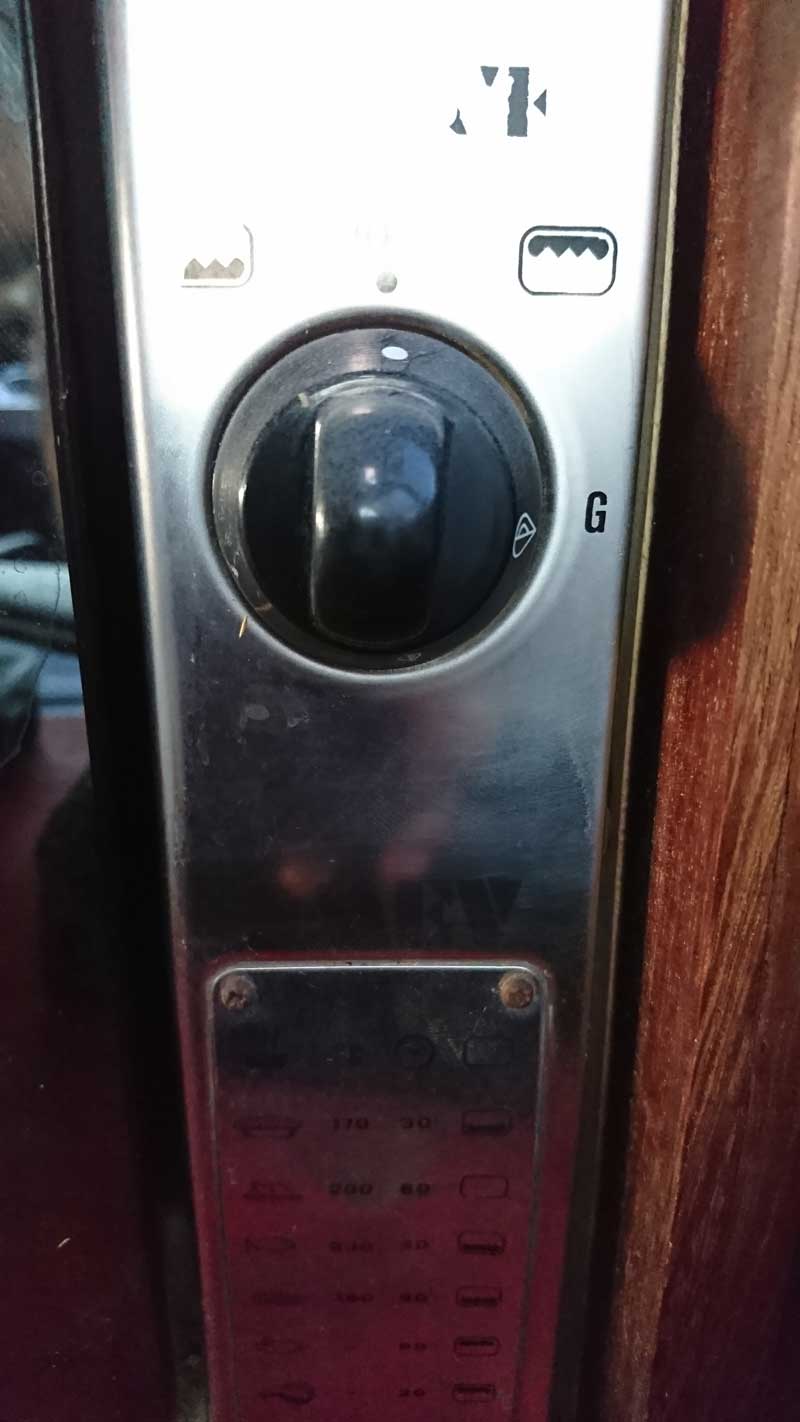

Right, first of all, my SMEV is model 3110. Oddly, you have to undo the four screws that hold the label printed with the type of food and time to cook on the bottom righthand of the fascia, remove the alli label and turn it around, if that's not odd, I really don't know what is.

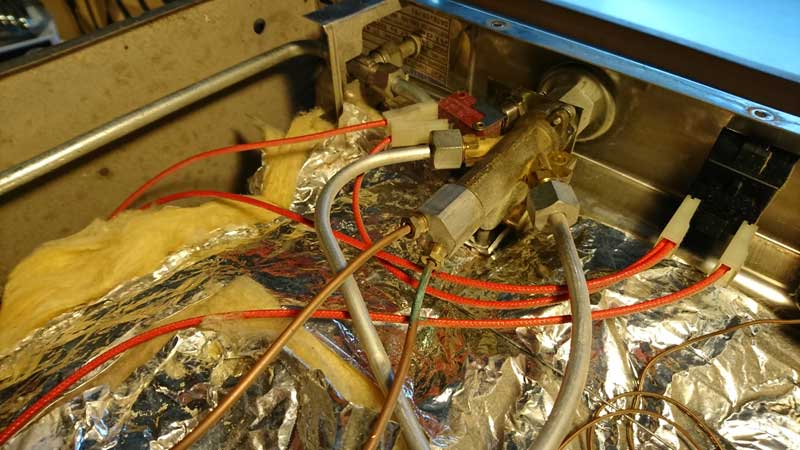

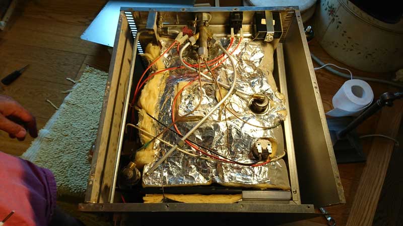

So with the help of a good friend (registered gas engineer/fitter) that happened to be visiting we undid the sides of the oven and after removing way too many bolts, we realised we only really needed to undo the righthand side panel. All pipework is behind there:

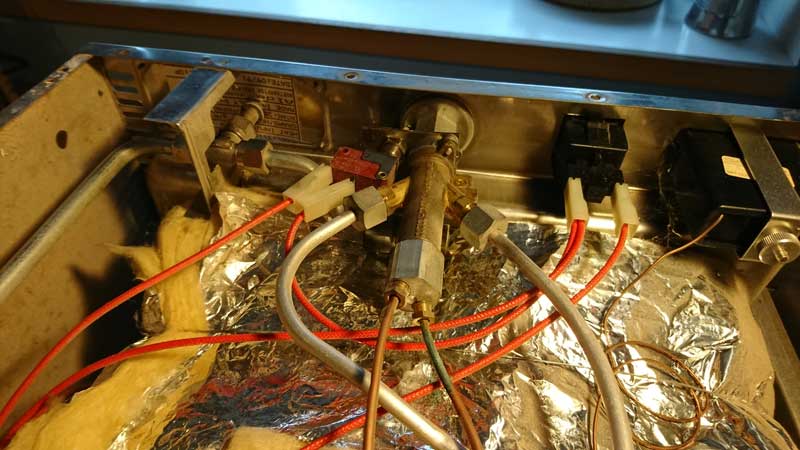

The L shaped pipe from the back of the oven to the tee behind the label on the bottom right of the fascia was the culprit. 10mins with a thin and then a thicker wire, got it completely unblocked and air went through it nicely. Bolted it back on, removed the jets, checked them, bolted everything back on, blew through the input and checked that the main knob did what's meant to be doing distributing gas to the grill, or oven as well as regulating supply to the oven.

How it got all this black carbon looking deposits blocking all the 40cm of the pipe is a mystery. As I said oven looks like it's never been fired up although it's 25yo according to the label!
