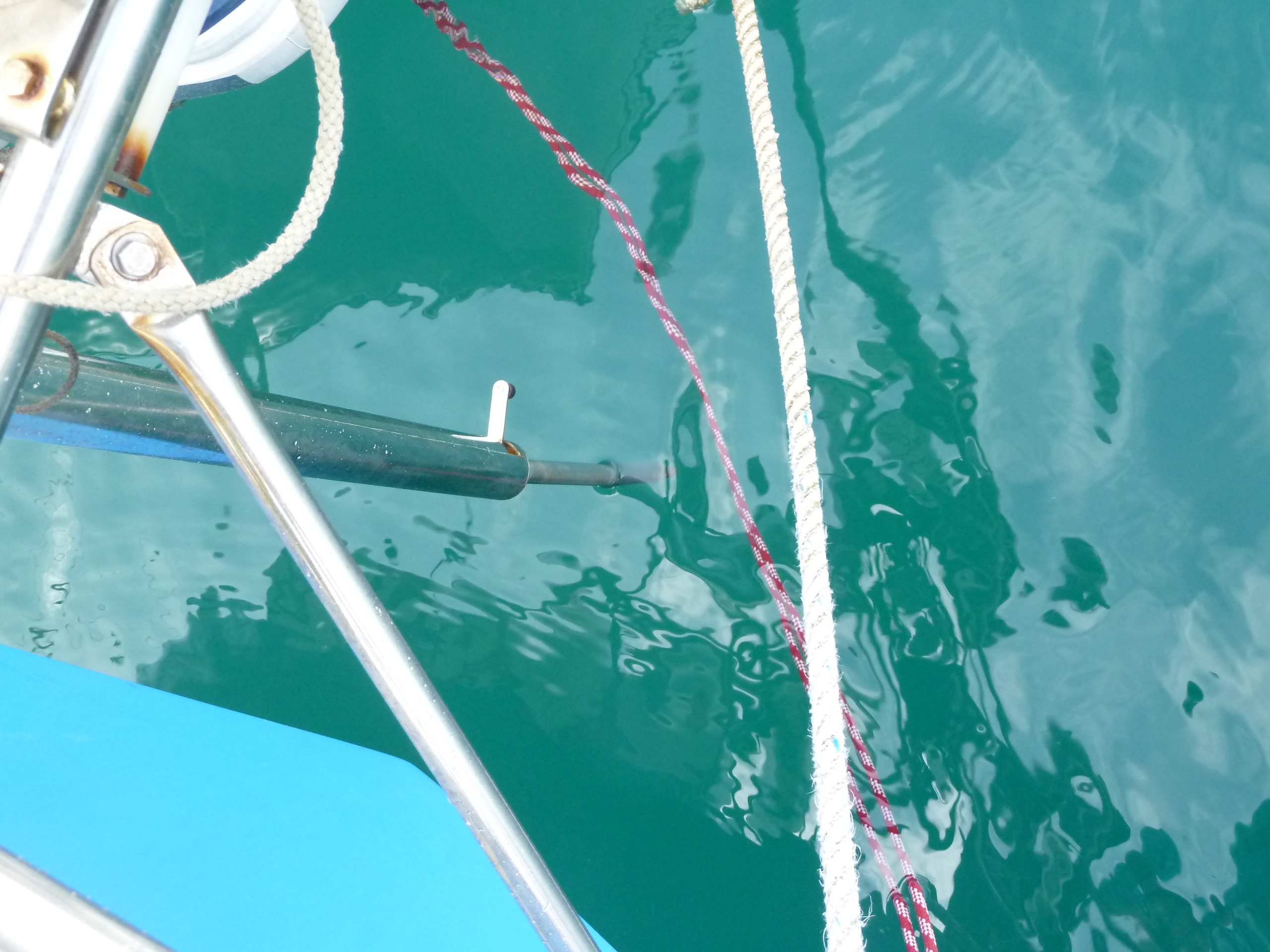

The instructions state that the vane should be locked, unfortunately it doesn't explain how one does this.
Hi Scilly. There's nowhere to put a continuous line as far as I can see. The vane is adjusted by turning a knob, as can be seen in pic two.
