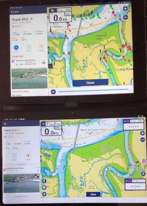

786FB2CE-1D62-43AA-80AF-48A4061B3EE7.jpeg On my iPad (top photo) you have facility to play back the track. Push play and the red pin moves along the yellow track showing your ever changing speed and direction along the route in the box, top left of screen. On my Android tablet and phone you don’t have that playback facility, just the static yellow route line. (Unless I’ve messed with some settings unknowingly....again)
