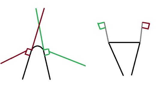

Take a walk around any marina and look at lights mounted on pulpits. The Dual lights such as I have on my 38 are OK as the light is mounted centrally. But individual lights are fitted to sides of pulpit - and the lights angles actually cross each other ..... Technically from dead ahead - both lights should be seen ... move slightly to one side and only that side should be seen ... but because of the pulpit design - the other light is still visible until a number of degrees offset.
Here I have tried to correct the horizontal division of light - but still the wedge is not enough to counter the pulpits angle. Also the lights are not perpendicular - needing further development of the wedge to correct.
On cabin sides - often the lights are placed where cabin sides are starting to angle toward centreline with no wedge correction. Plus a small amount of non vertical.
Its a common fault - nothing that prevents you being seen etc. - but in the case of the side lights sectors overlapping - this causes head on error ...

That is plain stupidity on part of the owner / installer. My point is fault of design. Pulpits angling in toward stem causing light sectors to overlap instead of being adjacent, as well as not being vertical.
My bicolor bow nave light has the same issue and I have considered fitting a shade to separate the two lights to shade each colour
The angle of separation of side lights beams is just bad design to as it only the brackets to be orientated correctly both vertically and horizontally with directions boards a seen on old sailing ships rigging mounted

Anyway - the angles I am highlighting in my post about errors are far more than 3 degrees and a walk round any marina will soon show up boats that have this problem.
