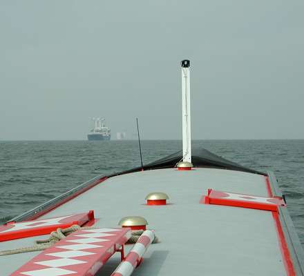

James Griffin, skipper and MD of Wyvern Shipping, gave his slide show at my local club; we staggered out exclaming "What a bloody fool!"
Ocean Princess was NOT designed and built for seagoing voyages at all. Stormbound in Dover the authorities impounded the vessel until improvements were made - new foredeck, sealed doors, window covers etcet - and a whole stack of safety equipment, added. Even then his 'adventures' showed that he was no mariner, making Tim Spall look like a Yachtmaster.
But if you want a good larf, book him now!
They certainly intended to make it a sea going vessel, but didn't read the rule book very closely first.
It was only impounded, because it was over 70 feet long, so fell into a category that had to meet certain requirements for sea. Some of the items it fell short of were the number and type of flares, and the number of fire extinguishers.
I am guessing they designed the boat at 72 feet long, the maximum for the canals. Had they chosen 69 feet, they would not have been impounded and would not have been forced to make the changes, thought no doubt they would have been advised to. If I were designing a narroboat, I would make it no longer than 55 feet, then it would be able to navigate all of the canals. At 72 feet, it has some limitations on the inland waterways.
It may not be sea worthy by the definition most on this forum use, but it has made some long passages and it didn't sink, so I think it met it's design criteria.

Narrowboat design for sea
There's more people going to sea in NB's than I realised.
Assume you've covered the cratch area, protected the windows, fitted washboards or whatever, to stop the thing filling up, then how stable would a flat bottomed 7' wide well ballasted boat be?? Also assume ballast well fixed, and as low as possible (and 10mm bottom panel). Flat bottom gives max form stability, but lots of heavy steel topsides would mean what sea-state before rolling?
Assume 50 to 55 feet long, then how important would longtitudinal flexing / metal fatigue be - here steel topsides must help.
That's why Telford decided Tubular bridges were a good idea & motorways are built using box girders. Terry Darlington did not detect any flexing or twisting. I'm sure he would have had a suitable humorous comment if he had.
Sailing barges are flat bottomed & carry a large spread of sail. Most waves would be longer than high, so probably unlikely to roll a boat over or create enough synchronous positive feedback to capsize a narrowboat. The bigger issue is probably breaking waves knocking her over, or punching windows or door in & flooding her.
Not looking for a fight, but would be interested in other opinions.
