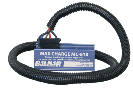

Surely almost any boat battery system has some kind of charge controller such as a Balmar Max Charge 614 (or whatever).
This connects to the field wire of your dumb alternator.
Doesn't that make the alternator smart???
The word "smart" can mean many things. It may mean the alternator changes its output similar to a multi-stage mains charger. In this case the voltage will probably always be above the VSR switching threshold so will work fine. An alternator that is managed by the engine management system, as in many modern road vehicles, may also be referred to as "smart" but in this case, to get the optimum performance, economy, emissions the onboard computer will, under certain conditions, deactivate the alternator output completely. This will instantly cause the VSR to open then maybe rapidly open and close as the computer is fooled by a bigger fluctuation in battery state of chage than it is programmed to expect. This mostly affects campervans when someone fits a VSR. Not heard of it happening on a Marine engine.
