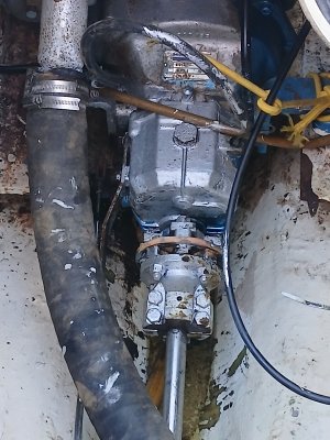

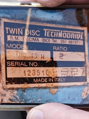

Hi all
A pal of mine has a nanni engine mated to a TCM40m gearbox. Twin disc technodrive.
In 2025 it started to delay engaging forward gear. Can be 20 seconds, but sometimes it's better, seems random. It's ok in reverse.
Gearbox fluid changed and it was a bit dark.
It is not the morse cable. Still does it with cable disconnected.
Any suggestions as to a fix.

Unfortunately the TMC40 has a significant history of such problems. Usually it is premature wear on the forward half of the clutch cone and requires either replacement or a new gearbox. There was a technical bulletin issued a few years ago detailing how to adjust the allen bolt on the gear arm to reduce the clutch clearance, which is moderately successful, and someone has said that roughening the clutch bearing surface worked for them. But the usual solution is to bite the bullet and buy a new gearbox.
The darkened ATF is again not uncommon and suggests that the gearbox is overheating - using DEX3 rather than the specified DEX2 is marginally beneficial as it has a better temperature range. These problems are well known to Beta and Nanni but yet they still use the TMC40 as their standard gearbox on the smaller engines.
No doubt someone will be along shortly to suggest gear linkage adjustment and the gearbox not going into gear properly, but your description of the problem is fairly diagnostic of the problem as clutch cone wear.
Thanks Amlov, we suspected the gearbox needed to be removed and new parts, likely a clutch cone. . But we were vainly hoping otherwise 😐
