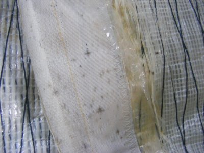

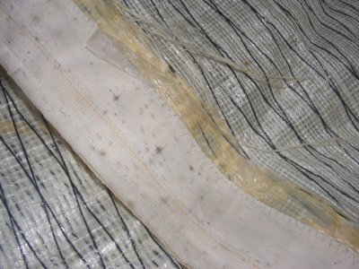

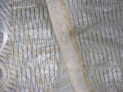

Here are a few snaps:
It's mainly a feature at the luff, you can see cellophane like backing coming away..
And in a few places strands starting to come away.....
There is only one small breach which I have covered with tape. It was stuffed in a bag.
Going to use it anyway, after fitting new luff tape.....Just curious about how long these things last towards the end and how well they keep their shape.
Shape will be more than acceptable for your use. An occasional loose strand isn’t a big deal, but the Mylar film breaking down is what kills these sails. Get some sticky backed sailcloth patch tape. Patch big and patch early.
The advantage of the mylar one is that whatever shape it is now is the shape it will be with 20 knots of breeeze in it, which won’t be the cae with the Dacron one, which is probably already stretched and hollow at the leech, and will be even worse with that 20knots. As Flaming says…repair tape, that isn’t that bad. My one was obviously well beyond repair tape, but I had an urgent need to sail to Normandy, and no alternative sail.
