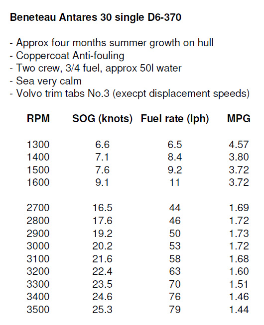

Here's some data I collected, the gap in data from 1700 - 2600rpm is the inefficient zone. Boat is 10.2m with single diesel.

you have a brand new boat with the latest ecu common rail injection and only weigh about 5 tons......super efficient!
As predicted you chug along at 2gals/hr at 7 kts which is a very good rule of thumb up to 34' and 6-7 tons approx. :)
