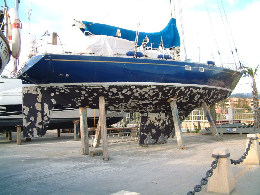

I'm considering an upgrade to a bigger yacht and found an older dafour arpeage 30, however its been surveyed a couple of years ago and they found the following:
above waterline moisture of 5
below ranging from 17 to 22 (antifoul scrapped etc)
Wicking to the glass fibre matting was evident all over the hull both above and below the waterline.
Also found 5 50mm blisters...
So I'm wondering how bad is this...I do like the yacht and its not expensive in comparison but wonder if I'm getting myself in trouble here...would appreciate any advice,

Different moisture meters (Tramex / Sovereign) will give completely different results and they're not comparable - you need to determine which one was used.
If there are already large blisters showing then there is obviously a problem with hydrolosis / osmosis and you could be getting into deep water.... Maybe best to avoid unless you're confident you know exactly what you're getting into. There are plenty of other good boats out there just waiting for you. ;)
On the reading through antifoul aspect.FWIW I read my tramex at 100 locations on the hull when the gell coat was off and hull dry, I repeated after a mm of epoxy and again after primer( silver stuff) and again after antifoul. The readings were identical.

The wicking is a sign of bad lay up, so a builder making that sort of error could also have made loads of other errors, avoid it, loads of good second hand boats out there.

Well hows that for a turn around...the owner is willing to accept £4k for the arpege subject to survey and sea trial ofcourse...I have read up on the osmosis info and talked to the surveyor that carried out the survey who mentioned that on the soverign a scale (which was the one used) it indicated between marginal and wet (mid way before the wet indication) and what he said that resale may be an issue if untreated but should be no structural issues providing I fix the 5 blisters...it seems that this isnt as bad as I thought, I dont really care about the resale value as I will be going abroad with her anyway and so my main concern is structural strength...

Hi, all boats will have osmosis, as all boats by capilary action draw in water,the real problem is how much they draw in. A sea trial will give you some idea about the Nova, The Dufour is ideal if you want a boat that you will end up knowing from stem to stern, You say the Nova is ready to go, but there will always be things that need renewing and changing to suit you, so the question you need to ask yourself, What one suits you and your situation best. Draw up a pros and cons list and go from there, its all down to what space and setup suits you best, and only you can answer that.
