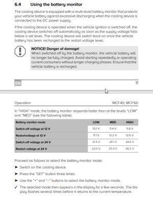

what does "input to unit" mean IR? the terminals in the actual coolbox or the cigarette lighter socket?
Looks like you have enough voltage drop to move the switch straight to LOW imho.
Had to move to low just now with Victron showing 12.85V.
