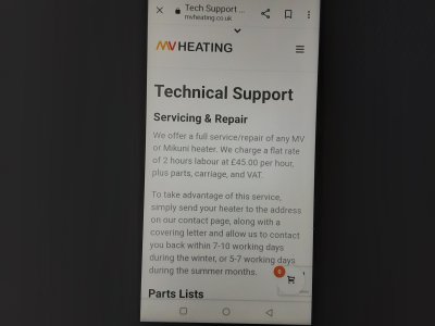

Mv heating serviced mine a couple of months ago, I still have the invoice for the service and gauze filters that they replaced plus 2 hours labour charge and postage. They were really helpful, I don't understand why they would say that.
That’s what they told me on the phone today. Maybe I’ll call tomorrow and see if I can get someone else…….
