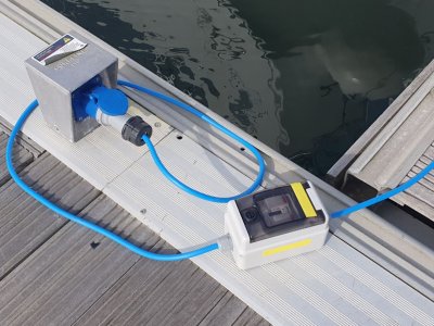

I decided to build my own, total parts cost £45.
Meter module £13.95 - Din Rail KWH Energy Meter 5 (32) Amp 240v Electric Credit Analogue *UK Seller* | eBay
MK Commando 16A male connector £5.70 - 240v 16 Amp 3 Pin MK Commando Plug - Blue - IP44 | MK (K9001BLU)
MK Commando 16A female connector £8.60 - 240v 16 Amp 3 Pin MK Commando Coupler - Blue - IP44 | MK (K9101BLU)
Wiska Weatherproof Enclosure £15.48 - 3 Way Weathertight Enclosure IP65 c/w Din Rail | Wiska (1303/W)
2x 20mm glands £1.18 - 20mm Nylon Compression Gland White for Cable 6-12mm² - LSF
Cable I had in stock as I had already made up two custom length shore lines so minimise coils of wire when moored at base but it was this cable I used - 2.5mm² 3 Core Arctic Flex Blue - Cut to length
I'd seen other "home made" ones on the pontoons at various MDL marinas so was ready for a discussion when they came to check readings but they weren't in the slightest bit bothered.
