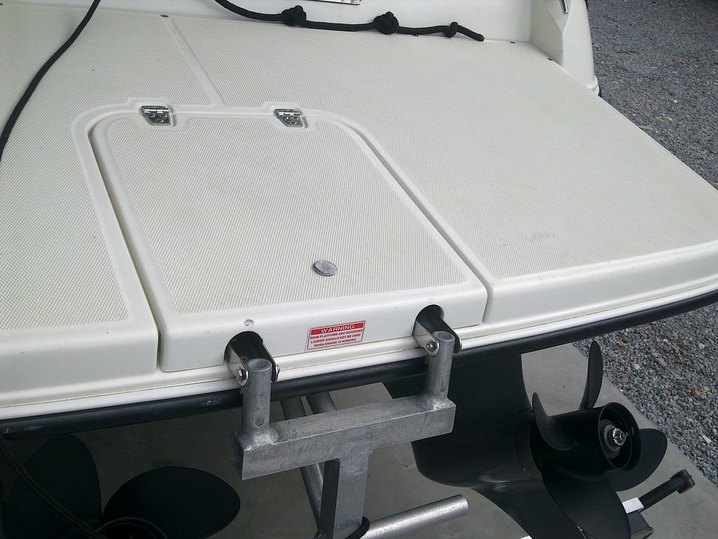

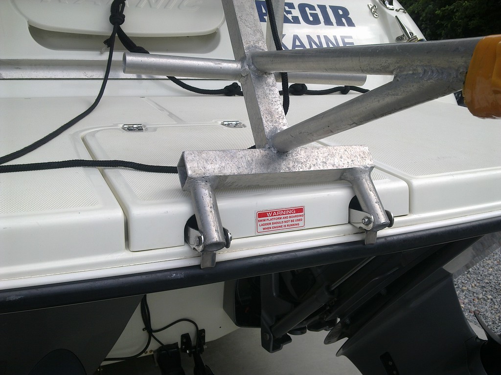

That's a great looking ladder, Bart. What's the other fabricated bit in the 3rd pic, doesn't look right for a bottle rack.
Hi guys,
BartW - that is fantastic! Had not even thought of attaching it to existing ladder mounts. Great job and perhaps a better way forward for me. Thanks very much for your help.
