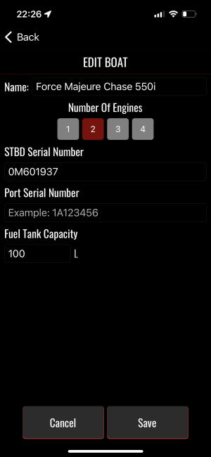

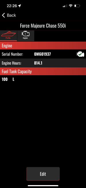

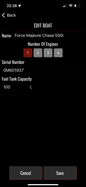

Try going in here and making sure you have them both set up here properly as port and starboard

So do you have one or two VVM devices ? Is there a junction box or two under the helm ? If you are just trying the one device into each engine by changing over to see if it works, I don’t think it will know what it’s doing. You’d only get one engine info at a time and only if you had each engine set up as a different boat and engine. If you get me. It won’t recognise one engine at a time alternatively under the same boat header or account set up. You really need to have it set up to have two engines selected under the same boat (as shown in the pics o sent above) and the device plugged into a junction box at the helm..which is connected via individual cables back to each port on the engine.

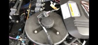

Is this the plug you mean. I’ve this 4 pin plug. I’m nearly certain it was a rinda that was plugged into this by a dealer years ago. Not certain though.
The four pin connector is for diagnosis using CDS, to connect the vessesl view mobile. has your engine got 14pin round engine to helm harness?
