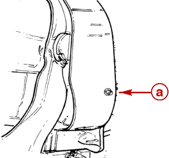

Edit: here is a picture showing where the grease nipple is on the outdrive:
