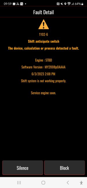

Took our new boat out this weekend and I found on a number of occasions it would cut out when I shifted into neutral. Starts straight up afterwards though.
We have the Vesselview bluetooth module connected, but being new to it all I never thought to check that for faults!
Anyway, I saw today that there was a fault registered, see screenshot.
Shift Anticipate Switch - seems to be the brains that kills the engine for a split second to allow the gearbox to move from Forward to Reverse - that's how I read it anyway, happy to be corrected!
I guess the fault is that the split second isn't working so it's just killing the engine?
Anyway, does anyone have any experience of this, and more importantly, of fixing it?!
Is it a simple job, or does it need a mechanic?
Any advice as always appreciated. Cheers 👍🏻

First thing is to check the shift cable is adjusted correctly on the quadrant where the two cables meet on the starboard riser. If thats ok then its usually a sign that the short wire going down to the drive needs replacing, they get stiff with age and it triggers the interupt switch for too long. Its a drive off job and needs adjusting accurately after replacement.

Great reply spannerman, thank you!
Now, as a general DIYer with basic skills - is there a drawing anywhere that will show me exactly what/where I need to be checking?!
And assuming that's ISN'T the problem, then it sounds like it's definitely a mechanic's job!!
