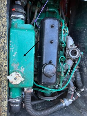

Thank you! I can see coolant when I remove the cap. Is that sufficient or is there a measure I should be using?
Oil is checked and at a good level.
Thanks again much appreciated!
Pd
Yes as long as you can put your finger in when cold of course and feel wet. it's also an expansion chamber so don't overfill otherwise it will just gush out of the overflow when hot.
On my Perkins I can see the level mark inside the heat exchanger.
