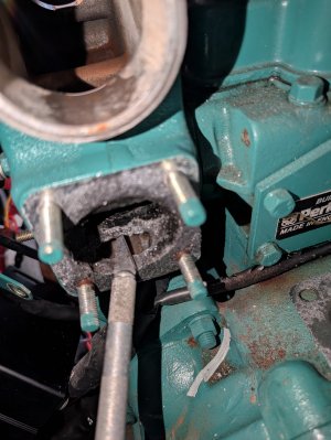

We were taking the boat through the crinan canal. All of a sudden the overheat alarm went off and the engine stopped. We managed to get tied up.
I took it apart and there was a hole corroded through, we had lots all coolant. New part not available, second hand part a week away.
I went and got some epoxy and patches the hole, jammed a cable tie in the radiator cap spring and ran the expansion pipe up the side of the door frame making a steam engine style sight glass.
Then I plumbed in our cold water feed through a valve to the engine at the calorifier so I could keep topping it up. 2 days trip back, lots of stress!
