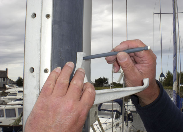

There has been some valid comments about the detailed design of mast.
Halyard wrapping
foot slipping off.
Falling and foot catching instep support.
I fitted something similar to these folding steps with a upstand to stop your foot slipping off. Also no upper loop to catch foot if you slip
Fixed steps like these should also have an upstand to stop your foot slipping off and easy to make and can be made from aluminium strip in 2 pieces.
A line can also be threaded between each of the steps on each side of the maast to help prevent halyard wrapping around the steps.

Are these steps in the lower picture just hooked into holes in the mast? I don't think that would fill me with confidence.
rogerthebodger
3 Nov 2001
12,589
I just picked the pic from Mr Google.
It looks like it only clips in and I would not trust that.
My folding steps are now bolted on with M6 stainless cap screws tapped into the 5mm thick mat wall.
I did have then pop riveted using 5mm aluminium rivets as I could not get monel
Sailboat mast steps by Cape Horn | NauticExpo
Seems they are designed that way as they can be fitted as you go up and removed when you come down
