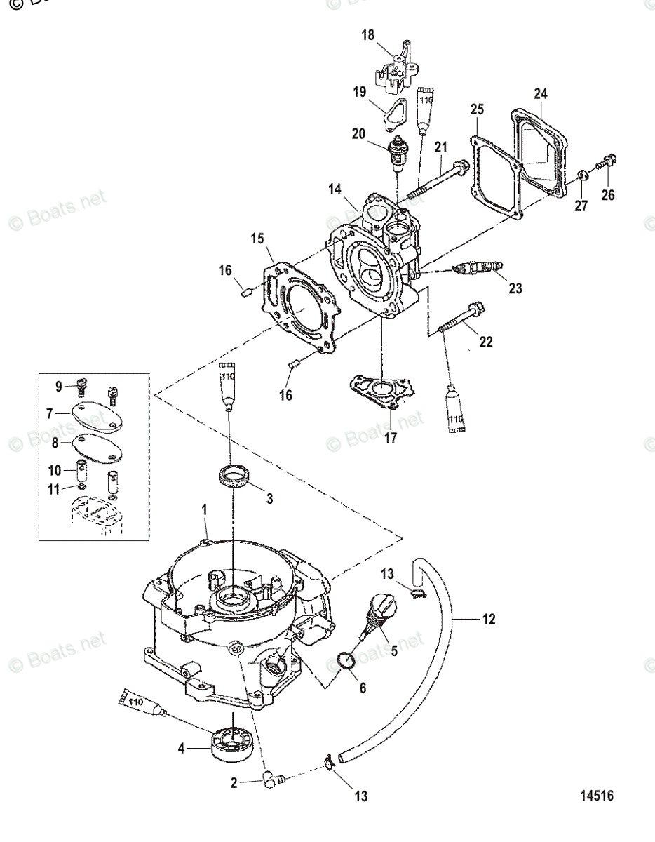

If it's a 4 st its under a cover on top of the cyl head
Many thanks for the reply, it's a four stroke, serial number OR63349. Is the cover on the cylinder at the back of the motor, if it is I think I know were it is. Thanks again.
#20 is the thermostat. Should just start to open at 52 C
