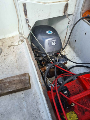

I don't have any model numbers but here is a picture of the motor in the boat.
