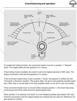

Synchro syncs the engines together, there is a limit in the offset it will bring the rpm to the same, been a few years since I looked at the manual for the MAN engine control, you can operate it as a single lever as well.
Troll is where the clutch slips to give you a lower speed with a maximum of 1000rpm, it can overheat the gearbox oil if there is no oil cooler
Slip & Grip starts out like the troll but as the rpm of the engine increases the clutch engages to give full drive.
There should be a manual available from the MAN website
This is what I can find on my HDD:
Appreciate the reply. I cannot find any manuals online - have looked for a little while now. Well some engine manuals I have but nothing relating to iSea controls. May email them. Had hoped to read in more detail but this gives me a start. Practice when out at sea I guess.
Check out the attached file.
I'm not sure it's applicable to your system, but AFAIK all MAN electronic gizmos are actually made by Rexroth...
