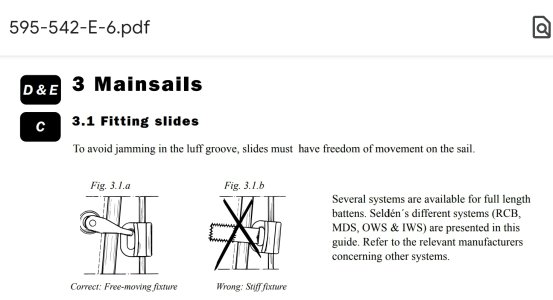

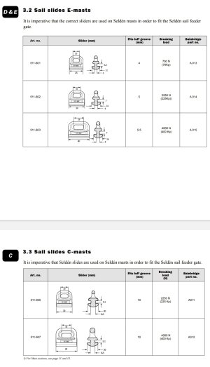

You say that you had new sail slides this year. Are you 100% sure they are a perfect match for the luff groove?
Some don't realise that brands like Selden make a number of different (but very, very similar looking) slides which vary depending on both luff groove width as well as section..
Details in their Sailmakers guide below, including a section on how to tell which mast section you have (if yours is a Selden spar) and how they need to be loosely coupled to the sail.
https://support.seldenmast.com/files/595-542-E.pdf

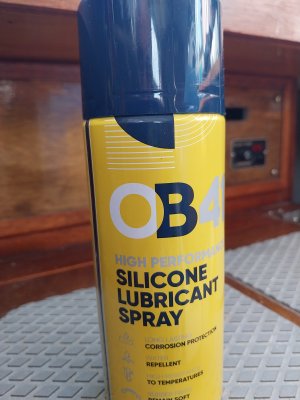

I bought this from Screwfix £4.75 seems to have done the trick. Also sprayed the companionway sliding hatch rails and it has made a big difference.20231015_151247.jpg
