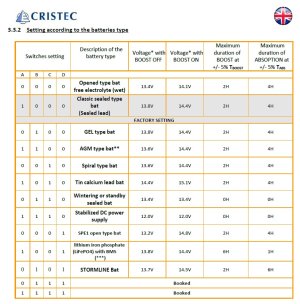

Not lithium but my boat has a mixture of lead acid (engine & domestic) and AGM (bow thruster). The Cristec charger has 4 DIP switches where you select the battery type. Having spoken to Exide and Cristec, they both said set the charger to the battery type with the most capacity (in my case, lead acid domestics).
The charger had been set to AGM and if left on trickle, the lead acids would gas and set the CO alarm off. I set it to lead acid open type and the issue has stopped.
The Lithium settings on there are wrong.
