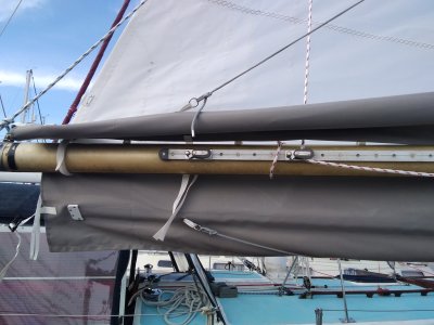

Only pic I can find...

If you are prepared to go to the bother, then there is a much better way to fit the stack pack cover.
Buy the track that caravan people use for awnings & pop rivet a length each side of the boom . Slit the existing cover down the middle & fit 2 new bolt ropes. Slide these in the awning tracks. The mainsail can now run in the track or be loose fitted as required.
One of my mainsails is 1/3 fitted to the boom. That is best as I can lower it. Take the slides from the mast & whilst it is laying between the 2 sides of the covers I can put sail ties around it. Then I can easily withdraw it into its sausage sailbag, which I lay on the foredeck. I can do this with the covers in place so the sail does not flop all over the deck. I like the !/3 solution as it allows me to free the clew off when saling but still keeps it retained close to the boom unlike a loose foot.

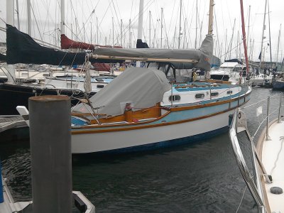

Keep up the annual swearing game until you need (or can afford) a new mainsail and stackpack. Things have moved on since that basic design. Photos show the loose footed mainsail.stackpack arrangement from Kemps. Not particularly new - they made similar for my Eventide in 2012!
