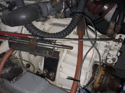

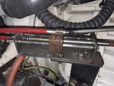

Looking for help/advice. We've had issues with the block which takes the cables from the upper and lower helm positions to engage/change gears. Can you tell what this is called, and any guides about how to set them up?
This is the block
And this is the rest of the linkage onto the Hurth gearbox.

Is it a recent problem or one that has been getting worse, is it just the gearbox or throttle as well, do you problems at both helms or just one?
It is known as a D S UNIT ie dual station but not one I recognise it looks bespoke or even home made
The angle on the cable seems excessive which maybe a reason for problems
On reflection has this been posted previously?
Thanks for replies - it's been an evolving problem, but perfect when bought tail end of last year, I posted previously re the starter not working, replacing a solenoid, but it was an electrical switch on the Hurth gearbox which would not allow the feed from the starter to the solenoid unless in neutral. Adjusting the cable to allow for that (or some other reason) meant initially I couldn't get reverse, then forward, on the SB engine from either helm position. The angle in the cable/rod connection to the port engine is even worse, but seems to work OK, however the start of the problem was when during servicing the rod to cable connection broke during engine servicing, you have to crawl over the gearbox to get to SB side of the SB engine. I've taken video's of the operation of the cables/block/selector for the SB engine (and nothing seems obviously wrong) and will do so for the port side to compare. Engines are 250 BTA Cummins with Hurth 800A2 gearboxes in our Aquastar 38.
I would release the both ends of the cable and see if there is free movement, I wonder if it's not been lubricated for a while and gradually seizing up.
I agree with @scottie about the angle of the cable👍
Incidentally, we had the port gearbox cable shear whilst mooring on our berth, thankfully it sheared when in neutral. It took a few seconds to fathom when was going on ie throttle response but no thrust ahead or astern!
It’s one of these:-
DriveForce Dual Station Unit for Gearbox and Throttle
You wouldn’t think that it would make much difference, but it’s important that these units are well greased

This was an easy one for me as I have these units fitted on my PRM500 gearboxes.
Fit and adjust the cables with the helm controls and gearbox lever in the neutral position. Then adjust the position of the actuating rod on the gearbox lever to match the length of travel provided by the cable movement of the helm controls, to ensure you achieve the required position of the gearbox lever when in gear. Hope I’ve explained that ok 😃

With plenty of grease and a 1/2" adjustment we seemed to have resolved the problem - gears now engaged from upper and lower helm positions. Fascinated to see, because comparing with the port engine, the lever on the port engine goes backwards/appeared to be in reverse, to drive the boat forward. I've had suggestions that the props might not be pitched the same to allow for the extra gear. What a learning curve!
