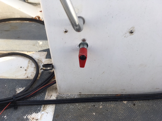

Upon inspection and with the right tools and spare battery I was able to diagnose that it was the battery isolation switch that had failed.

Those battery isolation switches (90 degree red key type) are carp!
I ended up replacing 2 on my old Avon SR4 rib. The second switch only lasted two years!

I know they are poor but in the space I have and the holes etc already drilled I cant seem to find an alternative hence my idea of the wire behind as a bypass when plugged together

Is your battery isolator switch on your windy on the "outside" and exposed to the weather?
just asking as mine was on a RIB and was routinely splashed with sea water and the rain. Unfortunately fault finding was problematic as using a multi meter would show good voltage across the switch when it was made, but as soon a a large load was put through it (i.e engine cranking) it would fail.
My current boat has a similar switch but it is "indoors" and doesnt suffer water ingress, so far so good :-)

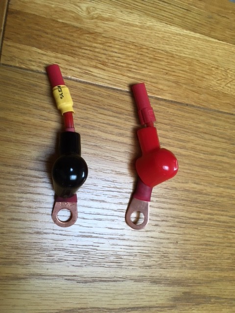

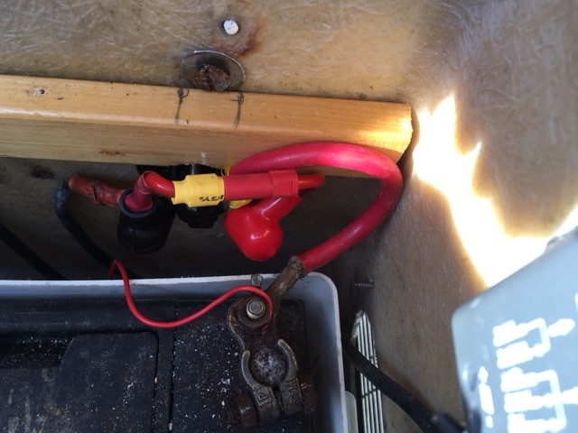

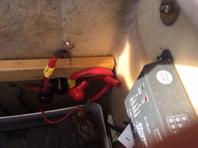

Put in the new switch which looked better quality than the one I took out. And then made up the rear bypass wire. Now all I need to do if the new switch fails is to lift the seat and remove the inner shelf in my and connect the two wires together and the switch will be bypassed.
I used XT150 Connectors which claim to be good got 150 -250 amps. All I know is is started the engine ok
