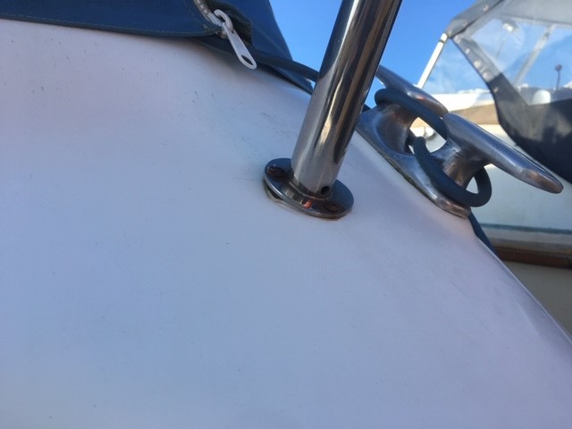

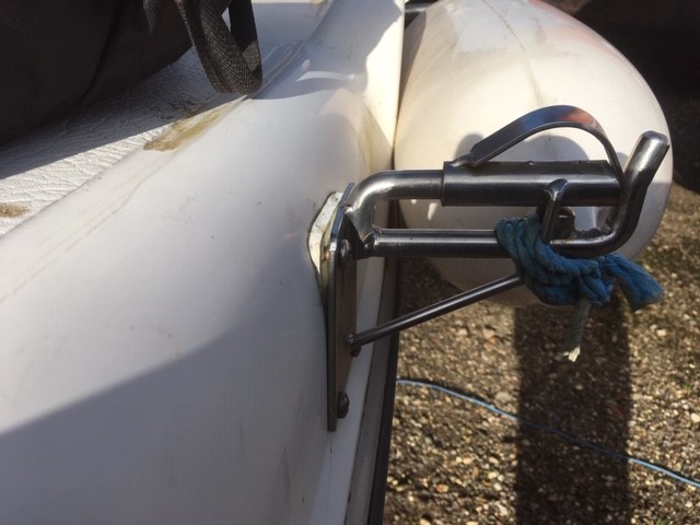

On my Sealine S24 I have a few items fixed to the boat where the fixings are loose and I have no access to the nut at the rear so it just keeps turning.

Mask around the object. Tap in small wedges to take up slack. Fill gap with CT1 and smooth off.

Looking at those fixings that sounds like a good idea to me. Other wise you will end up taking the boat apart for what appears to be a cosmetic issue.
Yes indeed...… I suspect for those who get a little afflicted with OCD that would not do but it will do for me :)
I would imagine that, on both of those fixing pictured, it would be possible to get behind them. The snap davit almost certainly would have been installed post build. You may need a small child to get into the gaps though :)

Having owned a S24 ( great boat) I‘ve been trying to think how the bracket was fitted and I guess it was before the rear seat back was sikaflexed in.
Bit extreme but if all ease fails you could tyre leaver the seat back off to expose the nut.
when I say tyre leaver I mean pull a little cut the sika, pull a little more etc
