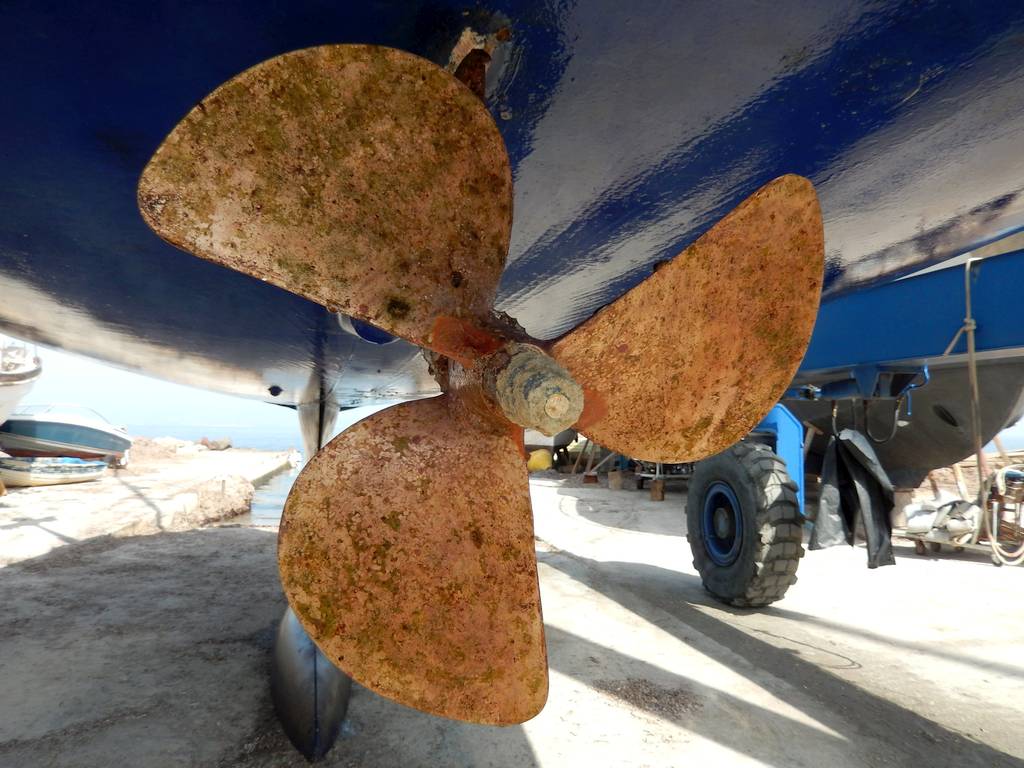

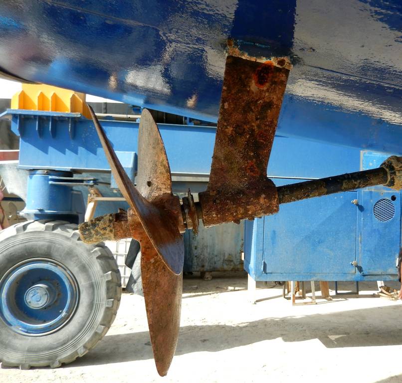

I may just have been lucky this year as I did notice fouling was light anyway. I didn't even dive to clean anything when afloat. Pictures below are just after lifting but before pressure washing had started.
Propeller had little growth (Burnished and given one coat of Equimins pre-launch)

I would have said that that propeller was not particularly good (because as a rotating item it should shed a lot of the film in use) & the P bracket is poor, yet you seem to think that it is OK.
If your hull has not been jet washed then it is miles better than my coppercoat (after only 10 weeks)
However, back to your comment re the log. I used ECO from force 4 & did not have to clean the impeller all season (although the boat did get lifted mid season for the coppercoat to get washed so may have got slightly washed during that) & the echo sounder transducer worked OK as well. Expensive but should get several coatings from it if the shelf life lasts.
I agree, the prop and P-bracket don't look good to me. My photo shows our worst result with Velox in the Agean, lift out end of 2016 season. We spent a lot of time that year not moving, including a period away from the boat in August followed by a water pump failure, so fouling by tube worm was quite bad. Most other years have been far better, a couple of times no fouling whatsoever.

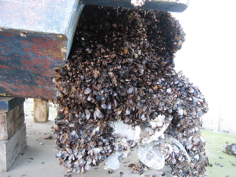

Yes, yours looks very clean with Velox. I've never used antifoul on the prop., just burnished it (plus Equimins for last few years). I still think that the prop. was pretty good (as per first picture) after a season without any antifoul. We were static in Ionian for about 6 weeks and again for several weeks in the Aegean. However, my expectations have been coloured with a few seasons in the Rias (that's when I started using Equimins). I've seen a pair of outdrives looking like a 1x1x2m box of shellfish after a year in the Rias. :D:D.
I thought it was the worst prop. fouling I'd ever seen (not that you could see any sign of a prop. in the picture :D:D). I couldn't find that picture but think that this might be one I took later after a couple of guys had hacked off a large amount of the fouling to reach the propellers.
