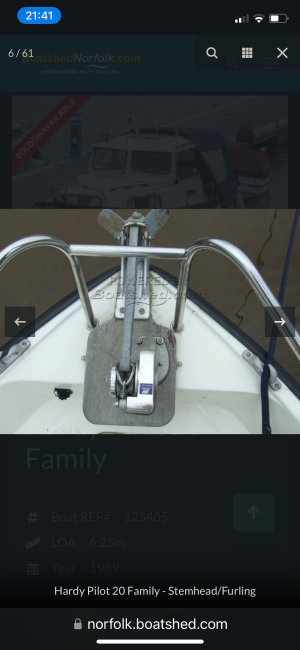

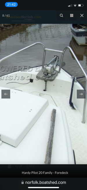

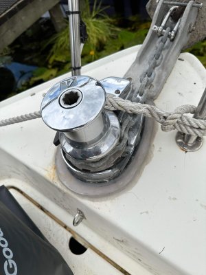

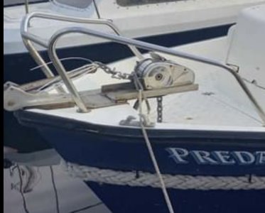

Now that you’ve mentioned the drum I’m asking myself about the best position for the winch. Another owner of similar boat has removed central double cleat post type thing and replaced with drum which serves as replacement post.
However I see that not enough room for anchor in his set up and more typically this boat (Hardy Pilot/Fisher 20) owners for a box or timber/metal plate and windlass to that.
So in fact in this set up the winch could be horizontal or vertical, it’s not straightforward in either case.

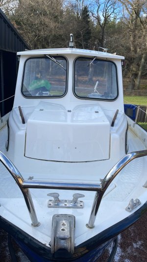

If winch mounted on plate or box bit further back then double cleat post could remain which is ideal for swinging Maureen. Few photos for reference, mine without and others with

Thanks for tips, going to stick to swinging Maureen by the cleats and figure a way to keep her cleats and add a wench winch
