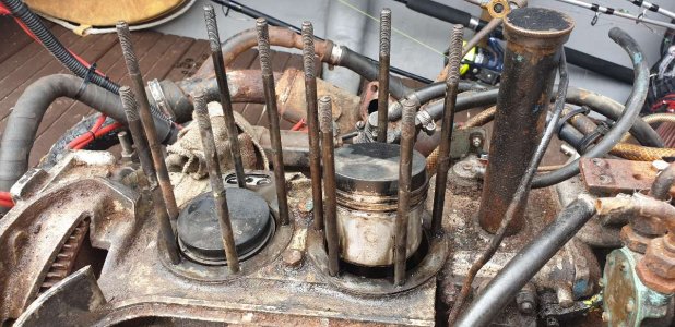

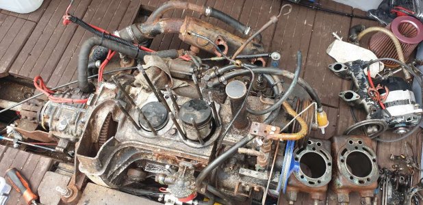

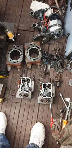

Hi all
My AC2W has an issue where it cuts out when hot, idles fine when cold, it starts ok, had some white smoke from the exhaust under load and noticed drips of seawater coming out between the barrel and cylinder head.
The top end of the engine is now stripped, heads are having a light skim but look in decent condition, obvs new head gaskets being fitted and i will be adjusting the bump clearance as req (on removal of the heads i checked bump clearance i was measuring 0.035, tolerance is 0.022-0,026)
Do you think the cutting out issue could be a separate issue?
I am seeing a few posts online with the same issue but none come up with an answer, they all seem to suggest fuel pump issue, could pump timing cause that?

Quick update, i rebuilt the engine this morning, bump clearances spot on, valve clearances spot on, I stripped heads replacing valve stem oil seals and gave the valve a good lapping in (not done that in a while), so far so good, had the engine running for a good 40mins, no nasty surprises, couple of weeping water hoses that needed a quick tighten but so far so good, engine idles well and revs well also appears to be a bit more responsive, sounds better as well, run out of time today so didn't get chance to take the boat out for a spin, that will be the telling time! Will have to wait a fortnight for that.
I would love to set the min and max rpm up but without a tachometer its near on impossible to set it correctly other than by ear, Ive bought a digital rpm reader but doesn't seem to be very accurate.
Cant seem to upload an mp4 compressed video of the engine running?
