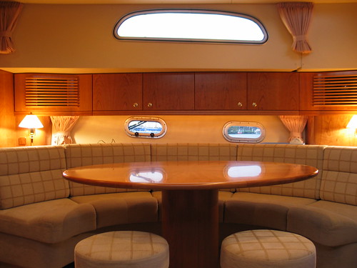

Yes, we have a combination of dimming lights, rope lights and lamps, that give the ability to make it nice and cosy. Took this some time ago to try and show the balance of lights, but its not really that good a photo:
Rick
