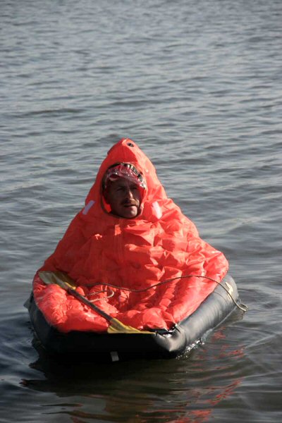

I have seen a one man liferaft. IF I can get permisions from the guy who took the picture and the guy who can be seen in the liferaft I will post the picture here.
Question is :
Where can I get one?
Is there a two man version?
