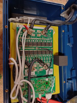

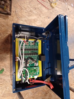

I popped the little blue plugs over top of the screws and opened up the lid .... mmmm now I have sent picture to them asking wich terminal to unscrew and then rescrew ... as nothing has any voltage there .. I am reluctant to lift the board / go further without info ...

OK .. success ...
I asked via another forum - in the Lithium section about this .. and a guy I know on there answered and its now working.
He reckoned dealer / supplier was wrong .. that their advice would have no effect at all.
Guy advised that the smaller board on top was the BT board and that the way to reset was to actually disconnect ALL leads / plugs from it ... wait and then reconnect. There would not be any need to discharge / recharge ... in fact he reckoned I could induce battery to SLEEP mode as seen in many videos.
Yesterday - I did as he said and saw a couple of LED's flash on the board on reconnection. My Samsung A34 phone still refused to connect. My Nexus tablet still refused ..
Today I thought - lets try again ... battey has been on slow discharge all night ... and now should be about 50% ...
Disconnected all plugs on BT board ... waited - then reconnected ... LED's flashed same .... Samsung A34 still not connecting ... but the Nexus fired up and showed battery at 47% .... discharge current 2.3A .. which agrees with the Wattmeter connected in the discharge circuit.
I then dug out my old S8 phone ... installed the app on that ... BINGO ... connected and showing battery status.
Strange though that Samsung A34 says no permissions - despite full access granted. But I have solution .. BT is now working ... I have stopped the discharge as battery is in good charge level for storage ...
