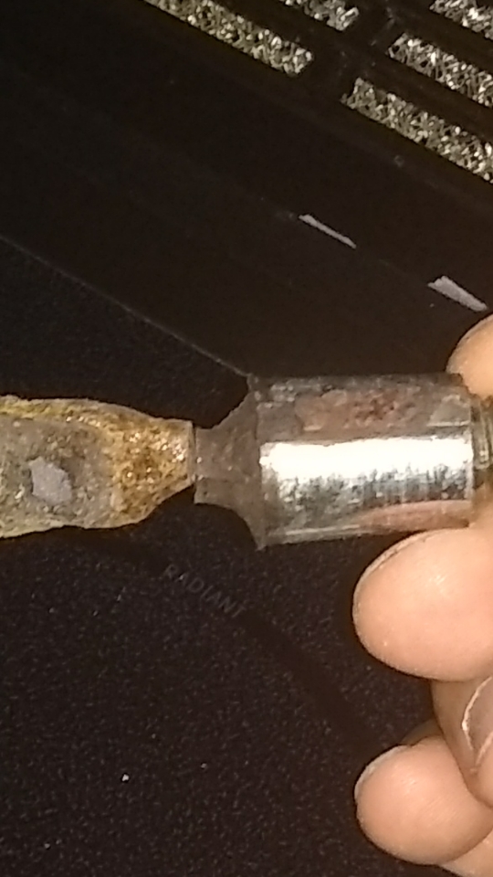

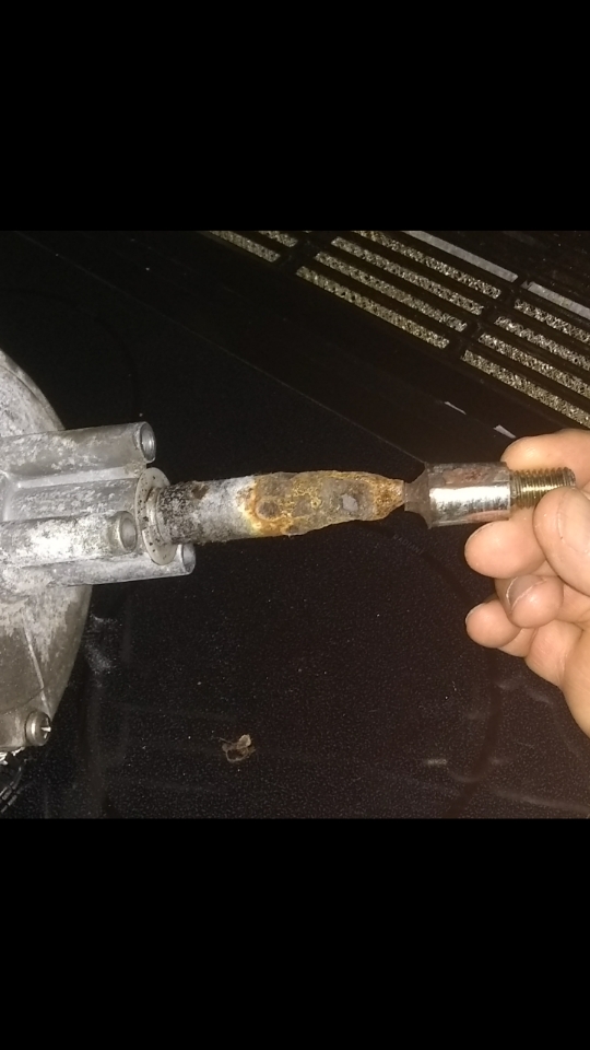

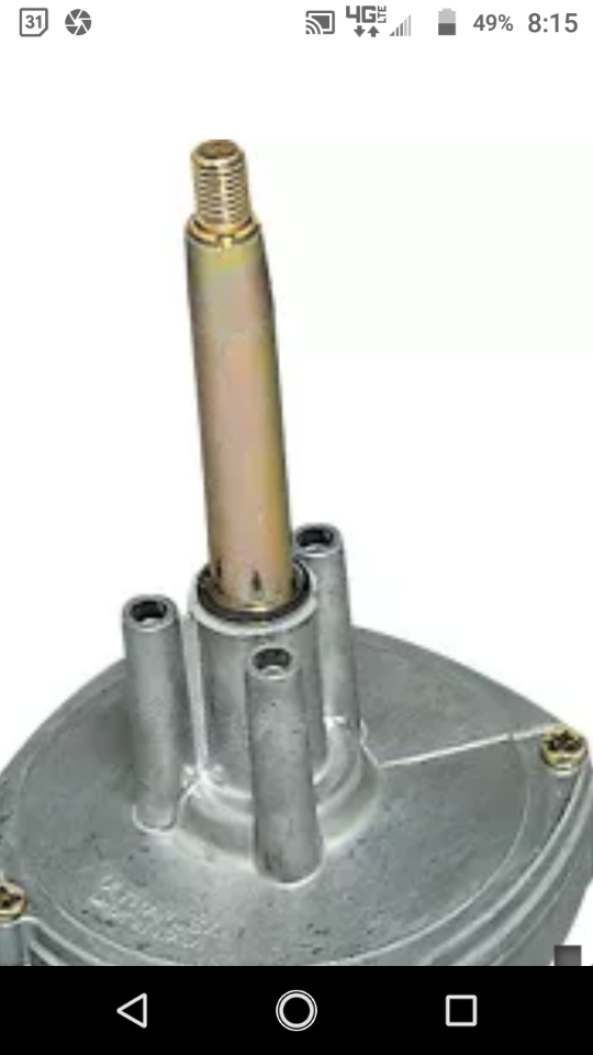

Last weekend my wheel broke off in my hands. The reason was obvious and was the problem you mention. My brass or bronze allow steering tapered shaft on my Uflex T71FC box was destroyed exactly at the location at the end of the iron woodruff key. Visual evidence is attached. The damage was hidden from me because it was under the bezel. When I removed the bezel 1/2 cup of rust fell to the deck.
A stainless key or maybe brass would have lasted forever. Thanks for posting this topic.
