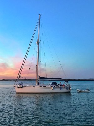

Just purchased a used stack pack mainsail system and I want to install a couple of blocks for the Lazy Jacks. My question is whereabouts should they be fitted and what type of blocks? I’ve seen loose blocks fitted to spreaders and and cheek blocks fitted to the mast. Since my mast is down I can easily fit the blocks wherever I want - so any thoughts on preferences for mast or spreaders? I should point out there are already signal halyards fitted to the spreaders.
