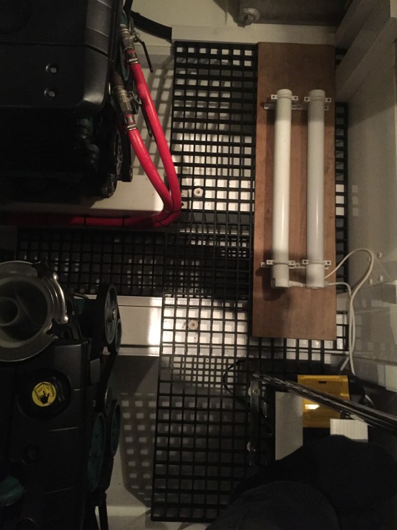

I have a not-patented “two tube heaters attached to plywood” device.
Dehumidifier thingy and an oil filled radiator will go onboard once lifted out, which will be shortly.
Planning on eating your dinner off the bilge floor I see!!
Did you install the grating floor? Look great
Grating comes that way as standard.
Bilge is not perfect - you would have a few crunchy bits of green paint flakes in your dinner.
Pet hates in an engine room no 1 Grating or Chequer Plate floor panels.
These might look fine in a ship or a commercial boat when the crew wear toetecter shoes and knee pads.
But on a liesure boat with a cramped engine room which you generally only go down when it is calm in port it is agony on the knees, to lie on or on the elbows.
I’d agree that it’s not comfy to kneel on. But there is enough space around and above the engines so that this doesn’t happen on a day to day basis. Another option is to sit on it, with feet on the lower section of checkerboard. This leaves you with a backside resembling a baboon that has sat on a waffle iron.
