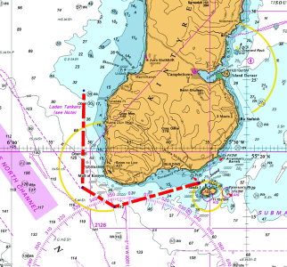

Forgive my ignorance, but the Chart suggests the disturbed water only extends a mile and a half offshore at the Lighthouse. At that point isn't it better to stay out in the 120m water?
Or are people just choosing to stay in the disturbed water to carry more favorable tide?

Probably yes, keeping a couple of miles off would help and that or more essential if attempting in bad weather. Watch out for the TSS boundaries (though rarely see a ship in it).
We always go round with gentle forecasts - wind strength, direction and sea state no more than slight - so generally there is a convoy closish to the shore, and rarely gone very wide. (Did go very wide once on a big boat in a F9 increasing F10+).
The lighthouse is well round the corner and I, for one, have a tendency to think I'm round before I am and get closer to the shore. In my boat when the line of surf appears it is too late to get out beyond it though I've never actually tried to reverse my track. The travelling water is going to take me there no matter what. My preference is for the mini water spouts that can form - tend to wake up any dozing crew when they land.

Well yes, but we've just established it's not essential to use the inner passage. The overfalls only extend about 1.5 miles, it looks like you can choose to just sail round the worst of it without adding that much time to the passage. Presumably you can also avoid the overfalls North of Sanda by errr, not going North of Sanda.
I understand people want the fastest favorable tide and don't want to lengthen their trip too much but those aren't essential.

According to the Admiralty atlas, there’s a W stream and an E stream occurring at the same time in Sanda Sound through much of the tide. Where your proposed route tracks the 50m contour it looks particularly disturbed. Maybe you’d have to go outside Sanda and therefore spend a significantly greater amount of time in unpleasant waters? The time from Arranman Barrels to the lighthouse looks about 50mins. Less time spent in a dangerous area = less risk? Perhaps that’s why the inner passage is popular?
As I said maybe it's better to go South of Sandra too. Or hit the worst overalls at slack tide. There seem to be plenty of options, I wouldn't rule any of them out. (Including going straight through the overalls with a load of tide with me which seems to be what everyone actually does.)

I think it's a bizarre place. West to east this last summer timed to come around with a decent tide running and... nothing. Others there at same time, wasn't just me. I was close in and sea just south of light was boiling, very glad it was flat calm otherwise.
Next time for me sanda sound then stand off from the light a good way.
I’m fast coming to the same conclusion, keeping just E of the SE corner of the TSS. It might just be a way of de-stressing the MoK. Something like this:
Agreed. Maybe no need to go as far out as tss, but be prepared to. When i came around there was a yacht shadowing me about 4 to 500 metres further out and it didn't look to me like the sea was disturbed where they were. But it probably varies from day to day.
