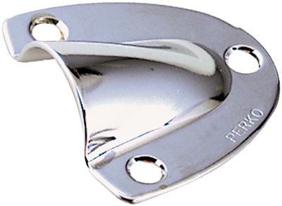

If the drain hole is below water much of the time you can also have water entering that way.
On fix for this can be a clamshell cover over the opening with the opening facing aft
