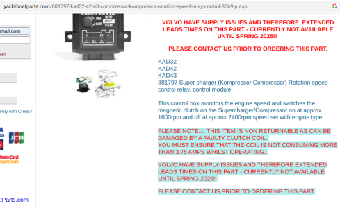

Replacing the clutch and the speed relay is the usual fix.
A new speed relay could be damaged by a faulty clutch coil - see below

I perhaps did not explain
If the clutch is faulty if may fry the good speed relay.
The attachment above suggests the following......
Oh I see. Ok. Maybe I won’t do that then. 🤣
