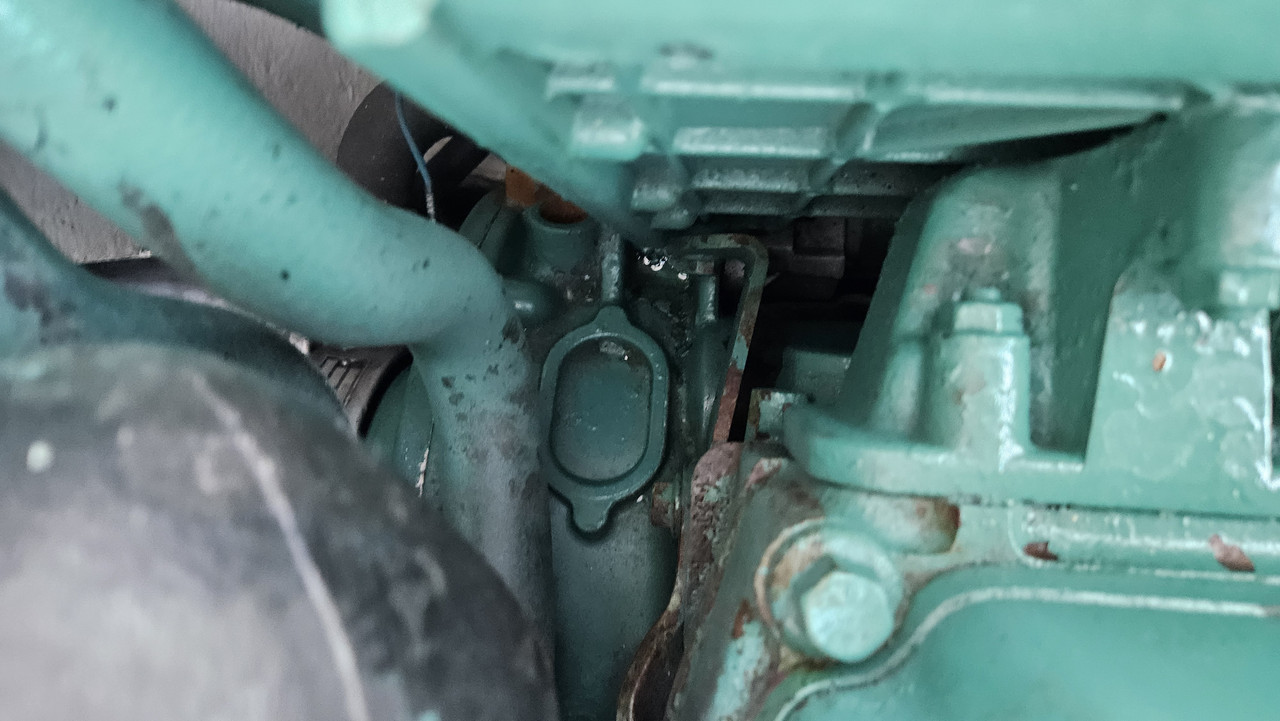

No crankcase breather filter and no fitting for it! See pics below.... Did some KAD32's come without a crankcase breather filter? (All of mine did, but I do not know the year of this engine)

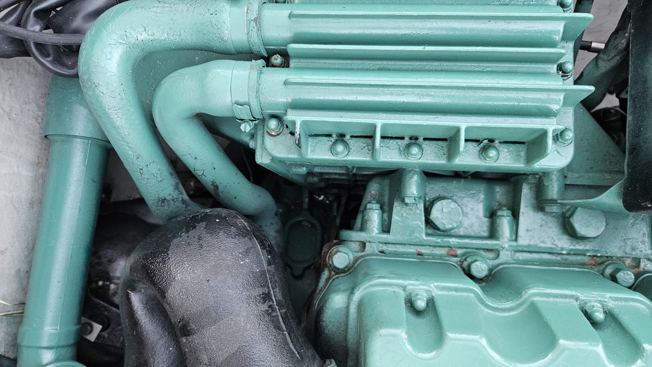

Second thing that struck me, is on the KAD32, there should be a breather hose coming from the top of the rocker, to somewhere?? The hose is missing and I cannot recall for the life of me where it goes to! (It's been a while since i've had a KAD32)

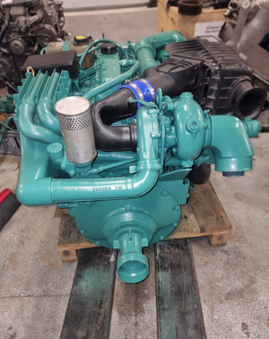

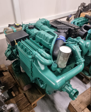

Great pics, thank you!
Yes, that's exactly what I expected to see, but there was no crankcase breather filter, or a housing for it to attach to, as you can see from my OP pics.

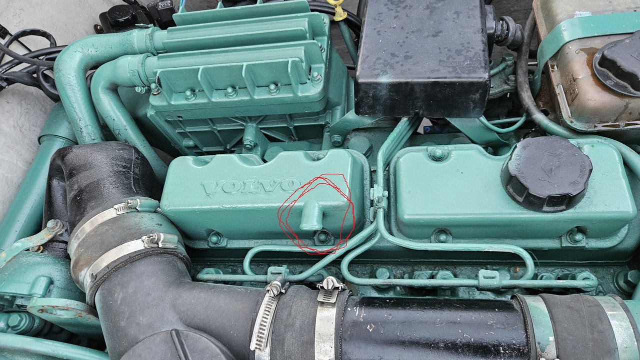

On my 41 that spiggot you circled in red has a hose going to the airfilter housing downstream of the filter element so crankcase fumes get burnt and exit with the exhaust. On earlier 41s there was a crankcase breather filter canister as shown in your first picture.Did the 32s evolve in the same way?
That's what i'm wondering.... did early 32's not have a crankcase breathe filter? All of mine did!

The best thing about the early engines with only the crankcase filter.
After a few thousand hours and the inevitable lack of filter change,it did ensure a nice film of oil over everything in the engine compartment greatly slowing down corrosion on engine parts.
