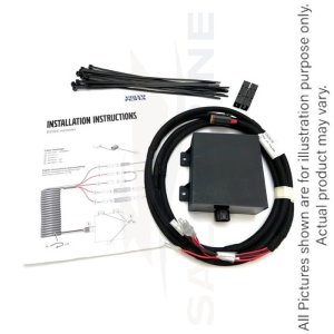

It is the DC - DC convertor!
Can you bypass this temporarily?
Also where is the best place to get another unit?
Costs seem to be very high!!!
Finally got to the boat to do some fault finding and kashurst thank you
Well done finding the cause.
Yes you can bypass it temporarily - really emergency use only rather than do a summer on it. And only if your batteries are in good condition. It's there for a reason it protects the ECU which is seriously expensive. It is a volvo specific bit of kit so your best bet is to phone around the usual Volvo marine suppliers. Brace yourself, I paid about £300 for one about 6 years ago. I tried finding a suitable alternative DC to DC convertor but it has quite unusual characteristics and there is always the niggling doubt about protecting the ECU.
Costs seem vey high! It could be worse, it could be a Yanmar part. ;-)
Thank you
This unit only has to hold the voltage stable during cranking so I can't see why it can't be any DC to DC converter that gives a stable 12v output?
Currently the price of a genuine part is over £900
Thank you

Need to take a look, but am thinking of trying an after market DC to DC converter as all it is doing is holding a steady output.
The input voltage was 12.4 v and output was 12.06 V of the good unit. So I'm sure an after market unit would be okay
£900 ouch! As @kashurst said, they used to be £300.
What I can't understand is that the DC/DC box seems to have 5 wires going in/out of it. Anyone got a wiring diagram?
I have been thinking about trying one of these units but set to power supply mode.
https://www.victronenergy.com/dc-dc-converters/orion-xs-dc-dc-battery-chargers
That looks like it would work. I do have a bit of a reservation in that it has multifunctionality and that is set up in software. You don't want it deciding one day that it is now a battery charger instead of a power supply. On boats I always work on the premise that if it can go wrong, sooner or later it will. Probably just me being paranoid.
Is there a basic DC to DC converter available that cannot change function?
Remote voltage sense (i.e. at the load end of the wire to compensate for voltage drop in the cable from the regulator to the load)?
