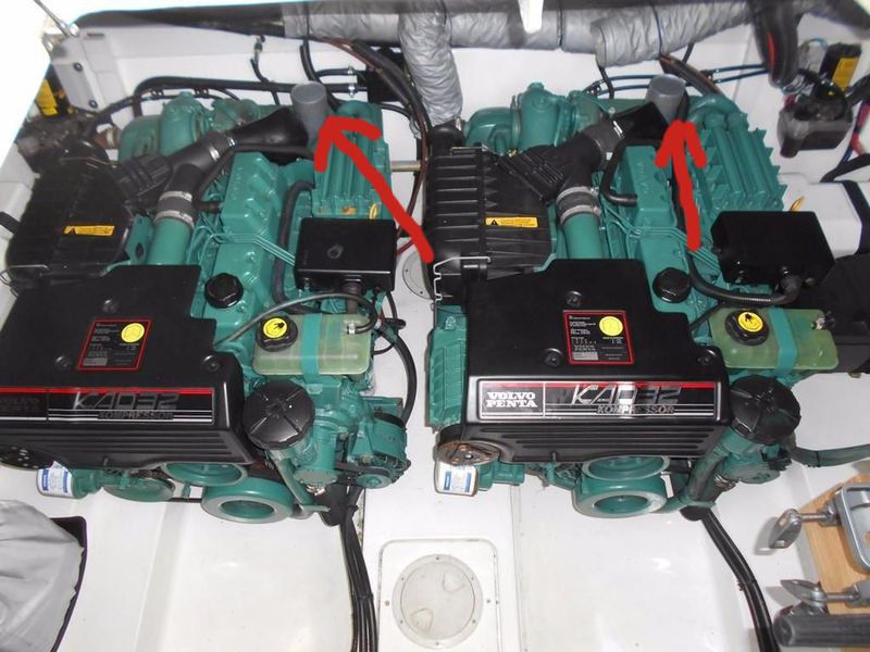

KAD32 has one, but I don't think there is one on a KAD42.
If there was, it would a be silver canister, right at the back, upper surface, slightly to the right of the centre line.
It unscrews upwards.
Look at that engine bay! I'm in love. You should see mine now. And I scrubbed it down 3 times this off season so I could marvel at it. C'est la vie. Anyway, no, I do not have any such filters. The pipes lead straight to the airbox and the filters are clean. I suppose that is a small mercy and I haven't popped a ring or piston at least.
