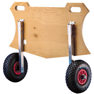

My first thought would be a gizmo a bit like the fold-up wheels on tenders - a bit of square SS channel, some SS tube to fit inside with a bolt as a hinge and some sort of clip to hold the tube up and down, but so the down one, at least would break free on impact. Mount the transponders on the bottom of the tube and fit the whole lot on the transom, as far away from the engine as possible.

Something like one of these, but with transponders on the bottom instead of a wheel?
That's what was in my mind ... but don't you think it a bit 'big' ??
